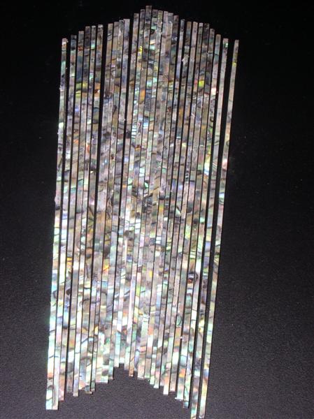

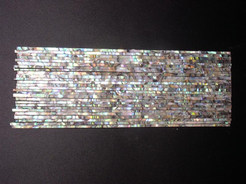

I have 28 pieces of paua abalam that range from .056 wide to .075 wide, these are off cuts that I made while setting up my jig. There all 5.5" long, and match stewmacs cruved strips in color perfectly.
If your interested email me for a price.

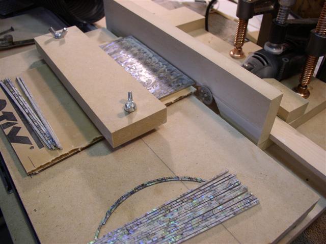

Lance, you holding out on us A new jig and you haven't posted it yet? Lets see what you were working on.
PostPosted: Tue Aug 09, 2005 12:10 pm
Don, it still needs refining but here is the idea.
The table that the shell is clamped to is on drawer slides and it moves the plate across the blade. I just loosen the wing nuts and bumb the shell to the fence, then run it across the blade. Then repeat
PostPosted: Tue Aug 09, 2005 12:17 pm
Cool Jig Lance, what sort of cutter are you using there ?
PostPosted: Tue Aug 09, 2005 12:20 pm
Thanks Lance. Another jig to add to my already lengthy to do list.

This batch of paua is still availible - make an offer if interested
